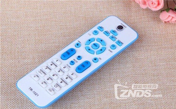

电视是每个家庭必不可少的家用电器,所以我们在使用遥控器的时间也会比较多。但如果遥控器换了怎么办,很多人都会想到配一个万能遥控器,那么万能遥控器怎么设置,它的万能遥控器设置方法是怎样的?下面我们讲一下具体的设置方法。
要设置好万能遥控器,必须知道电视万能遥控器代码是多少。下面是各类电视的代码
万能遥控器代码:
长虹
000.008.009.091.092.093.010.011.014.016.026.028.033.051.088.100.157.158.159.160.161.180.181.185.186.191.192.210.211.212.229.230.231.232
康佳
011.017.029.032.034.054.067.069.071.075.076.077.078.079.080.081107113117.173.174.175.176.189.201.202.203.217.218.220.226.267.236
创维
011.025.033.045.046.060.070.017.072.073.074.079.083.010.107.108.109162163.164.165.166.167.168.169.177.224.225.235.246
熊猫001.011.016.021.022.023.024.025.026.028.033.040.043.053.056.009.057.058051.061.062.073.079.089.091.124.125.234.237.238.239.240.241.242.243.244245247.248.249.250.251
TCL
051.053.068.071.073.082.083.084.085.110.111.170.171.172.178.179.187.188.197.198.199.200.233
海尔
103.112.118.119.150.151.152.153.154.155.156.182.183.184.193.194.213.228
海信
000.006.007.008.010.014.015.0 25.045.046.103.105.107.115.116.128.129.130.131.138
.139.150.151.152.153.154.155.156.182.183.184.193.194.213.228
金星
007.008.011.013.024.025.032.033.039.051.065.071.073.079.091.097.138
福日
007.011.015.023.024.028.033.034.040.043.053.056.060.061.065.079
安华ANHUA
017.001.032.047
百花BAIHUA
016.025.033.053.056.079
百合花BAIHEHUA
023.024.040.043
百乐BAILE
016.025.012.019.026.027.028.029.030.031.042
宝声BAOSHENG
011.025.016
北京
008.012.011.019.016.023.024.025.027.028.029.030.031.033.044.043.050.053.056.026.079.091.039.042.051.021.122.126
宝花石BaoHuaShi
033.053.056.079
彩虹CAIHONG011.025.016
彩星CAIXING023.024.040.043
长城011.016.017.023.024.025.033.040.043.053.056.001.012.029.027.026.028.029.030031.042.079
海虹HAIHONG
016.025.026.027.028.029.030
海乐HAILE
032.047
A.万能遥控器设置方法
第一步:从"代码表"中查出代表您要遥控的电视机的三位数代码。
第二步:先按住"设置"键不放,再按下"电源"键,然后释放两键,此时工作指示灯亮起。
第三步:输入您查出的三位数代码,如083,输入一位数字,指示灯闪烁一下,三位数字输入完以后,工作指使灯熄灭,设置完毕,你就可以使用本遥控器遥控您的电视机。
注:TCL电视机2980DB型号的代码为TCL083
B.自动搜索代码方法
第一步:人工打开您要遥控的电视机的电源开关,让电视机处于有节目状态。
第二步:将遥控器正对着电视机,先按住"设置"键不放,再按下"电源"键,然后释放两键,此时工作指示灯亮起。
第三步:按一次遥控器上的音量" "(或"-")键,并注重到电视机上的音量是否在增大(或减小),反复此操作,直至电视机上的音量在增大(或减小)时,停止操作,然后按一下"设置"键,此时工作指示灯熄灭,设置完毕。
