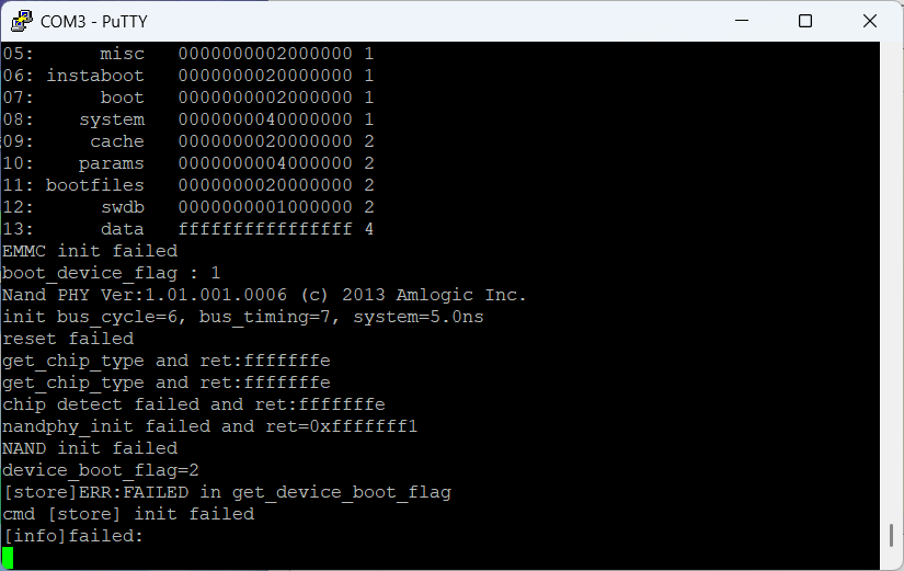

求大佬帮忙看看是不是硬件损坏,不是的话该怎么救砖之前到手一个趣书算云的PCDN电视盒子,芯片是晶晨S905L3-B,根据主板布局还有短接点+芯片判断盒子应该是创维的E900V21D,然后之前试图把Armbian写入盒子的EMMC,然后不知道哪一步出错了,盒子不开机了,然后线刷S905L3-B的通刷包也刷不进去了,卡7%然后报错“[32030201]UBOOT/获取返回/DiskInitial命令出错”,接TTL后上电一直提示“GXLX2:BL1:3cfee7:42a5ae;FEAT:ADFD318C:0;POC:3;RCY:0;EMMC:800;NAND:82;SD:800;USB:8”,按别的教程敲空格或者回车也没有反应,晶晨线刷工具7%报错时TTL显示“[info]fAIled”
线刷时候TTL的信息
  1. TE: 1395991036
  2. BL2 Built : 13:36:55, Jun 22 2020.
  3. gxl g85d6ad1 - longyong.chen@droid02-sz
  4. Board ID = 4, adc=303
  5. set vcck to 1070 mv
  6. set vddee to 1070 mv
  7. CARD_3 high, old board
  8. CPU clk: 1200MHz
  9. BL2 USB
  10. DDR3 chl: Rank0+1 @ 792MHz - FAIL
  11. DDR3 chl: Rank0 @ 792MHz - FAIL
  12. DDR3 chl: Rank0 16bit @ 792MHz - FAIL
  13. DDR4 chl: Rank0+1 @ 864MHz - FAIL
  14. DDR4 chl: Rank0 @ 864MHz
  15. bist_test rank: 0 28 08 49 3b 1d 59 1f 00 3f 40 23 5e 21 02 41 3f 24 5a 1c 00 39 3e 22 5b 596   - PASS
  16. Rank0: 2048MB(auto)-2T-18
  17. 0.0;
  18. TE: 1397164689
  19. BL2 Built : 13:36:55, Jun 22 2020.
  20. gxl g85d6ad1 - longyong.chen@droid02-sz
  21. Board ID = 4, adc=303
  22. set vcck to 1070 mv
  23. set vddee to 1070 mv
  24. CARD_3 high, old board
  25. CPU clk: 1200MHz
  26. BL2 USB
  27. 0.0;
  28. TE: 1397349134
  29. BL2 Built : 13:36:55, Jun 22 2020.
  30. gxl g85d6ad1 - longyong.chen@droid02-sz
  31. Board ID = 4, adc=302
  32. set vcck to 1070 mv
  33. set vddee to 1070 mv
  34. CARD_3 high, old board
  35. CPU clk: 1200MHz
  36. BL2 USB
  37. Load fip header from USB, src: 0x0000c000, des: 0x01400000, size: 0x00004000
  38. New fip structure!
  39. Load bl30 from USB, src: 0x00010000, des: 0x013c0000, size: 0x00007600
  40. Load bl301 from USB, src: 0x00018000, des: 0x01380000, size: 0x00002400
  41. Load bl31 from USB, src: 0x0001c000, des: 0x10100000, size: 0x00019600
  42. Load bl33 from USB, src: 0x00038000, des: 0x01000000, size: 0x0007b000
  43. NOTICE:  BL3-1: v1.0(debug):361f8a7
  44. NOTICE:  BL3-1: Built : 16:43:26, Dec 19 2018
  45. NOTICE:  BL31: GXL normal boot!
  46. NOTICE:  BL31: BL33 decompress pass
  47. [Image: gxl_v1.1.3103-9234004 2018-12-27 10:43:23 yao.zhang@droid07]
  48. efuse init ops = c5
  49. efuse init hdcp = c, cf9=7
  50. x2_hp_e = 0
  51. bl30: check_permit, count is 1
  52. bl30: check_permit: ok!
  53. chipid: 0 0 3 c c 0 93 b3 b0 a0 0 c5 not ES chip
  54. [1397.720641 Inits done]
  55. INFO:    BL3-1: Initializing runtime services
  56. WARNING: No OPTEE provided by BL2 boot loader
  57. ERROR:   Error initializing runtime service opteed_fast
  58. INFO:    BL3-1: Preparing for EL3 exit to normal world
  59. INFO:    BL3-1: Next image address = 0x1000000
  60. INFO:    BL3-1: Next image spsr = 0x3c9
  61. U-Boot 2015.01 (Mar 29 2021 - 19:48:51)
  62. DRAM:  2 GiB
  63. Relocation Offset is: 76e8c000
  64. [MSG]MMC init in usb
  65. aml_priv->desc_buf = 0x0000000073e7c630
  66. aml_priv->desc_buf = 0x0000000073e7e950
  67. SDIO Port B: 0, SDIO Port C: 1
  68. sleep - delay execution for some time
  69. Usage:
  70. sleep N
  71.     - delay execution for N seconds (N is _decimal_ !!!)
  72. Enter USB burn
  73. Set Addr 52
  74. Get DT cfg
  75. Get DT cfg
  76. Get DT cfg
  77. Get DT cfg
  78. Get DT cfg
  79. set CFG
  80. ID[16]
  81. tplcmd[    echo 12345]
  82. 12345
  83. [MSG]ret = 0
  84. [info]success
  85. BULKcmd[    low_power]
  86. [info]success
  87. ID[16]
  88. tplcmd[    download mem dtb normal 133120]
  89. [MSG]Down(mem) part(dtb) sz(0x20800) fmt(normal)
  90. [MSG]totalSlotNum = 0, nextWriteBackSlot 3
  91. [info]success
  92. [MSG]Burn Start...
  93. [MSG]load dt.img to 0x0000000001000000, sz=0x20800
  94. [MSG]Burn complete
  95. BULKcmd[download get_status]
  96. [info]success
  97. BULKcmd[disk_initial 1]
  98. dtb magic 08088b1f
  99.       Amlogic multi-dtb tool
  100.       GZIP format, decompress...
  101.       Multi dtb detected
  102.       unified board, board id = 4
  103.       Multi dtb tool version: v2 .
  104.       Support 13 dtbs.
  105.         aml_dt soc: gxlx2 platform: p291 variant: 2g
  106.         dtb 0 soc: gxl   plat: p211   vari: 1g
  107.         dtb 1 soc: gxl   plat: p211   vari: 512m
  108.         dtb 2 soc: gxl   plat: p215   vari: 1g
  109.         dtb 3 soc: gxlx   plat: p261   vari: 1g
  110.         dtb 4 soc: gxlx   plat: p261   vari: 2g
  111.         dtb 5 soc: gxlx   plat: p261   vari: 512m
  112.         dtb 6 soc: gxlx   plat: p265   vari: 1g
  113.         dtb 7 soc: gxlx   plat: p265   vari: 2g
  114.         dtb 8 soc: gxlx2   plat: p291   vari: 1g
  115.         dtb 9 soc: gxlx2   plat: p291   vari: 2g
  116.         dtb 10 soc: gxlx2   plat: p291   vari: 512m
  117.         dtb 11 soc: gxlx2   plat: p295   vari: 1g
  118.         dtb 12 soc: gxlx2   plat: p295   vari: 2g
  119.       Find match dtb: 9
  120. start dts,buffer=0000000007700000,dt_addr=0000000007700000
  121.       Amlogic multi-dtb tool
  122.       Single dtb detected
  123. parts: 14
  124. 00:      logo   0000000002000000 1
  125. 01:  recovery   0000000002000000 1
  126. 02:       rsv   0000000000800000 1
  127. 03:       tee   0000000000800000 1
  128. 04:     crypt   0000000002000000 1
  129. 05:      misc   0000000002000000 1
  130. 06: instaboot   0000000020000000 1
  131. 07:      boot   0000000002000000 1
  132. 08:    system   0000000040000000 1
  133. 09:     cache   0000000020000000 2
  134. 10:    params   0000000004000000 2
  135. 11: bootfiles   0000000020000000 2
  136. 12:      swdb   0000000001000000 2
  137. 13:      data   ffffffffffffffff 4
  138. EMMC init failed
  139. boot_device_flag : 1
  140. Nand PHY Ver:1.01.001.0006 (c) 2013 Amlogic Inc.
  141. init bus_cycle=6, bus_timing=7, system=5.0ns
  142. reset failed
  143. get_chip_type and ret:fffffffe
  144. get_chip_type and ret:fffffffe
  145. chip detect failed and ret:fffffffe
  146. nandphy_init failed and ret=0xfffffff1
  147. NAND init failed
  148. device_boot_flag=2
  149. [store]ERR:FAILED in get_device_boot_flag
  150. cmd [store] init failed
  151. [info]failed:
复制代码
线刷卡7%
线刷卡7%
线刷时TTL信息截图
线刷时TTL信息截图
 楼主| 发表于 2025-11-29 15:15 | 显示全部楼层
目前问题已解决谢谢各位大佬(插上外置硬盘后莫名可以刷入了)

发表于 2025-11-19 21:38 | 显示全部楼层
你可以试试能否重新刷一下
回复 顶一个 踩

发表于 2025-11-20 01:02 | 显示全部楼层
卡百分之七大概率是闪存芯片挂了,当然也不排除是其它方面的问题,闪存故障的可能性比较大
回复 顶一个 踩
发表于 2025-11-20 08:18 | 显示全部楼层
刷机包对但刷机卡7%是读取emmc失败,如果是能开机的,是带nand焊盘的检查nand焊盘引脚是否有操作短路造成物理短路,如果是不能开机能进入刷机卡7%的检查cpu与emmc的连接电阻是否开路,常见是4R17,这个容易判断就是cpu与emmc之间的电阻,没几个,阻值一般是20欧左右的,这个也被用做短路触发,任意端对地短路触发联机,操作用力容易造成一端脱焊断路。

 楼主| 发表于 2025-11-21 17:39 | 显示全部楼层
豆每豆丁的 发表于 2025-11-19 21:38
你可以试试能否重新刷一下
等会试试

 楼主| 发表于 2025-11-21 17:45 | 显示全部楼层
猎人0786 发表于 2025-11-20 01:02
卡百分之七大概率是闪存芯片挂了,当然也不排除是其它方面的问题,闪存故障的可能性比较大 ...
我看别的帖子说有可能是UBOOT挂了,不然早就丢垃圾桶了
