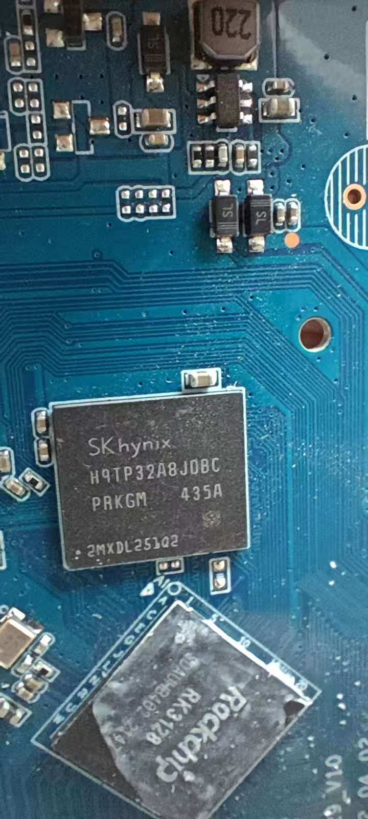

赛尼尔S7 开机卡logo 求固件,同问如何双清
 楼主| 发表于 2025-10-13 07:45 | 显示全部楼层
不知道怎么进去recovery

谢谢分享,我这个机子闪存挂了

发表于 2026-3-4 16:24 | 显示全部楼层
我的也起不来了这是TTL
   codec pll = 400000000HZ
Board:        Rockchip platform Board
Uboot as second level loader
DRAM:  Found dram banks: 1
Adding bank:0000000060000000(0000000040000000)
128 MiB
GIC CPU mask = 0x00000001
rk dma pl330 v*V玨%攻褋= 0 20
SdmmcInit = 2 0
storage init OK!
Using default environment
GetParam
Load FDT from resource image.
power key: bank-16777215 pin-255
No pmic detect.
[LZN Patch] light on keypad(GPIO1_A3) led.
[LZN Patch] close speaker volume(GPIO0_A2).
[LZN Patch] disable WIFI_BT-EN(GPIO0_D6).
[LZN Patch] disable WIFI_REG_ON(GPIO3_D3).
[LZN Patch] disable BT_RST(GPIO3_C5).
[LZN Patch] set low for spi pins.
[LZN Patch] set low for PANEL_UPDOWN(GPIO0_D1).
[15:52:37.187]收←◆set pwm voltage ok,pwm_id =1 vol=1250000,pwm_value=36
set pwm voltage ok,pwm_id =2 vol=1200000,pwm_value=45
SecureBootEn = 0, SecureBootLock = 0
#Boot ver: 2024-03-05#2.31
empty serial no.
vbus = 1
board_fbt_key_pressed: ir_keycode = 0x0, frt = 0
no fuel gauge found
no fuel gauge found
read logo on state from dts [0]
no fuel gauge found
vbus = 1
按开机键后
[15:52:52.558]收←◆[LZN DEBUG] Normal boot, power adc key pressed.
[LZN Patch] receive power key, going to system.
[LZN Patch] current BT_HOST_WAKE(GPIO3_C6) status : 0.
[LZN Patch] current BT_PCM_OUT(GPIO0_B6) status : 1.
[15:52:52.673]收←◆[LZN Patch] current PANEL_UPDOWN(GPIO0_D1) status : 1.
[LZN Patch] current WIFI_BT-EN(GPIO0_D6) status : 1.
Hit any key to stop autoboot:  0
[15:52:55.390]收←◆load fdt from resouce.
Secure Boot state: 0
kernel   @ 0x62000000 (0x007ad700)
ramdisk  @ 0x65bf0000 (0x00130834)
bootrk: do_bootm_linux...
   Loading Device Tree to 65600000, end 65617d8b ... OK
Add bank:0000000060000000, 0000000040000000
[15:52:55.478]收←◆
Starting kernel ...
回复 顶一个 踩
