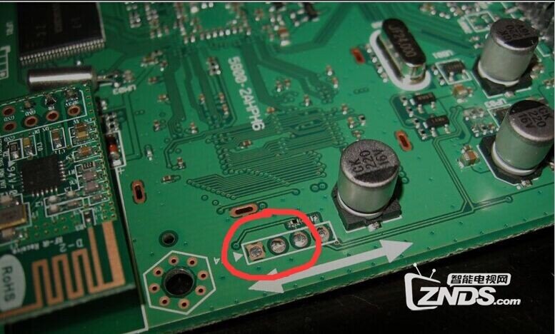

求助!天猫魔盒tmb100E TLL接线
查看数: 44461 | 评论数: 19 | 收藏 1
发布时间: 2015-5-26 14:10
完全[img=0,1]file:///D:\Favorites\1206669525\Image\C2C\5)VP1E960X9UXNU[N@DI6VA.jpg[/img]不懂啊!求教{:86:}
18994992234| 来自江苏 发表于 2015-5-26 14:22
ゝ.慌 发表于 2015-5-26 14:12
看论坛置顶教程啊
GND RX TX怎么看呢?我是100E

wokankan| 来自浙江 发表于 2015-6-1 19:58
SkyFire 发表于 2015-5-29 21:37
估计是Data分区变只读了,焊下spi flash,上编程器重刷入UBOOT,再接TTL查看是否有坏块,刷Data分区修复 ...
我觉得你说的对,我的魔盒突然出现存储空间为0,然后就卡logo了。以后买个编程器试试。
SkyFire| 来自广西 发表于 2015-5-29 21:37
18994992234 发表于 2015-5-29 21:15
刷的乐视,一直好好的,突然挂了
估计是Data分区变只读了,焊下spi flash,上编程器重刷入UBOOT,再接TTL查看是否有坏块,刷Data分区修复包,不行只能换NAND Flash。
18994992234| 来自江苏 发表于 2015-5-29 21:15
SkyFire 发表于 2015-5-29 20:51
之前刷什么固件。
刷的乐视,一直好好的,突然挂了
SkyFire| 来自广西 发表于 2015-5-29 20:51
18994992234 发表于 2015-5-27 18:43
EEEE I3000000032940xf300110003877520EEEE I400000004294_M6_BL1_3431>2534313
device is 16bit ddr
wait  ...
之前刷什么固件。
device is 16bit ddr
wait pll-0x03 target is 0204 now it is 0x00000203
DDR clock is 516MHz with 1T mode
516M clk
DX0DLLCR:40000000
DX0DQTR:ffffffff
DX0DQSTR:3db05001
DX1DLLCR:40000000
DX1DQTR:ffffffff
DX1DQSTR:3db05001
DX2DLLCR:40000000
DX2DQTR:ffffffff
DX2DQSTR:3db05001
DX3DLLCR:40000000
DX3DQTR:ffffffff
DX3DQSTR:3db04001
Stage 00 Result 00000000
Stage 01 Result 00000000
Stage 02 Result 00000000
Stage 03 Result 00000000
HHH
Boot From SPI0x12345678
Boot from internal device 1st SPI RESERVED
System Started
▒nv_init env_init 40
U-boot-00000-g3e9c579(m6_mbx_g32@jb42-0630) (Apr 08 2014 - 12:22:39)
aml_rtc_init
aml rtc init first time!
Clear HDMI KSV RAM
DRAM:  1 GiB
relocation Offset is: 105e8000
NAND:  Amlogic nand flash uboot driver, Version U1.06.017 (c) 2010 Amlogic Inc.
SPI BOOT : continue i 0
No NAND device found!!!
NAND device id: 2c 68 4 4a a9 0
NAND device: Manufacturer ID: 0x2c, Chip ID: 0x2c (Micron C revision NAND 4GiB MT29F32G-C)
1 NAND chips detected
#####aml_nand_init, with RB pins and chip->chip_delay:20
bus_cycle=5, bus_timing=6, start_cycle=6, end_cycle=7,system=5.0ns
oob size is not enough for selected bch mode: NAND_BCH60_1K_MODE force bch to mode: NAND_BCH30_1K_MODE
aml_chip->oob_fill_cnt =0,aml_chip->oob_size =224,bch_bytes =54
aml_nand_init:oobmul =2,chip->ecc.layout->oobfree[0].length=16,aml_chip->oob_size=224
aml nand env valid addr: 10000 ,status =0
key start_blk=2040,end_blk=2047,aml_nand_key_init:684
aml nand key valid addr: ff010000
aml nand key valid addr: ff210000
aml nand key valid addr: ff410000
aml nand key valid addr: ff610000
CONFIG_KEYSIZE=0x10000; KEYSIZE=0xfffc; bbt=0x1330; default_keyironment_size=0xeccc
i=0,register --- nand_key
NAND bbt detect factory Bad block at 5a00000
Creating 8 MTD partitions on "nandnormal":
0x000000800000-0x000001000000 : "logo"
0x000001000000-0x000001800000 : "aml_logo"
0x000001800000-0x000002000000 : "recovery"
0x000002000000-0x000002800000 : "boot"
0x000002800000-0x000042a00000 : "system"
0x000042a00000-0x000062a00000 : "cache"
0x000062a00000-0x000072a00000 : "backup"
0x000072a00000-0x0000ff000000 : "data"
nandnormal initialized ok
detect mx chiprevD :1 and nand_type: 0
nand_curr_device =1
MMC:   SDIO Port B: 0, SDIO Port C: 1
SPI BOOT,spi_env_relocate_spec : env_relocate_spec 53
do not to enable write protect for S25FL032A!!!
In:    serial
Out:   serial
Err:   serial
register usb cfg[0] = 9fe82948
Net:   current factory:3
default eth phy
Meson_Ethernet
init suspend firmware done. (ret:0)
detect_storage
nand exist return 0
setenv storage nand
reboot_mode=charging
ir init
switch_boot_mode
suspend_status_current2=0
current factory:3
Hit Enter key to stop autoboot:  0
compatible nand
Booting from nand ...
NAND read: logo whole chip
8388608 bytes read: OK
NAND read: boot offset 0x0, size 0x600000
6291456 bytes read: OK
pre-clear hdmi ram
hdcp get form storage medium: nand
name=nand_key nand_key
read:addr:0xff010000,phy_blk_addr:2040,phy_page_addr:8,aml_nand_get_key:125
device:nand, init key ok!!
don't found keyname,uboot_key_read:1502
prefetch hdcp keys from nand failed
## Booting kernel from Legacy Image at 82000000 ...
   Image Name:   Linux-3.0.50-gba996df
   Image Type:   ARM Linux Kernel Image (lzma compressed)
   Data Size:    3407353 Bytes = 3.2 MiB
   Load Address: 80008000
   Entry Point:  80008000
   Verifying Checksum ... OK
        Ramdisk start addr = 0x82340800, len = 0x1011bb
   Uncompressing Kernel Image ... OK
machid from environment: 0x4e27
EFUSE machid is not set.
Using machid 0x4e27 from environment
Starting kernel ...
[    4.545216@0] kobject (df8b9410): tried to init an initialized object, something is seriously wrong.
[    4.564757@0] dvb_io_setup start
[    4.568861@0] DVB: cannot get resource "frontend0_LNBON/OFF"
[    4.568892@0] DVB: cannot get resource "frontend0_POWERON/OFF"
[    4.574755@0] DVB: cannot get resource "frontend0_ANTOVERLOAD"
[    4.581279@0] Smartcard: cannot get resource "smc0_reset"
[    4.974041@0] init: hdmi hpd_status is :48
[    4.983585@0] init: cannot open '/initlogo.rle'
[    4.983790@0] init: load_565rle_image_mbx result is: 0
[    5.306168@0] init: Before e2fsck_main...
