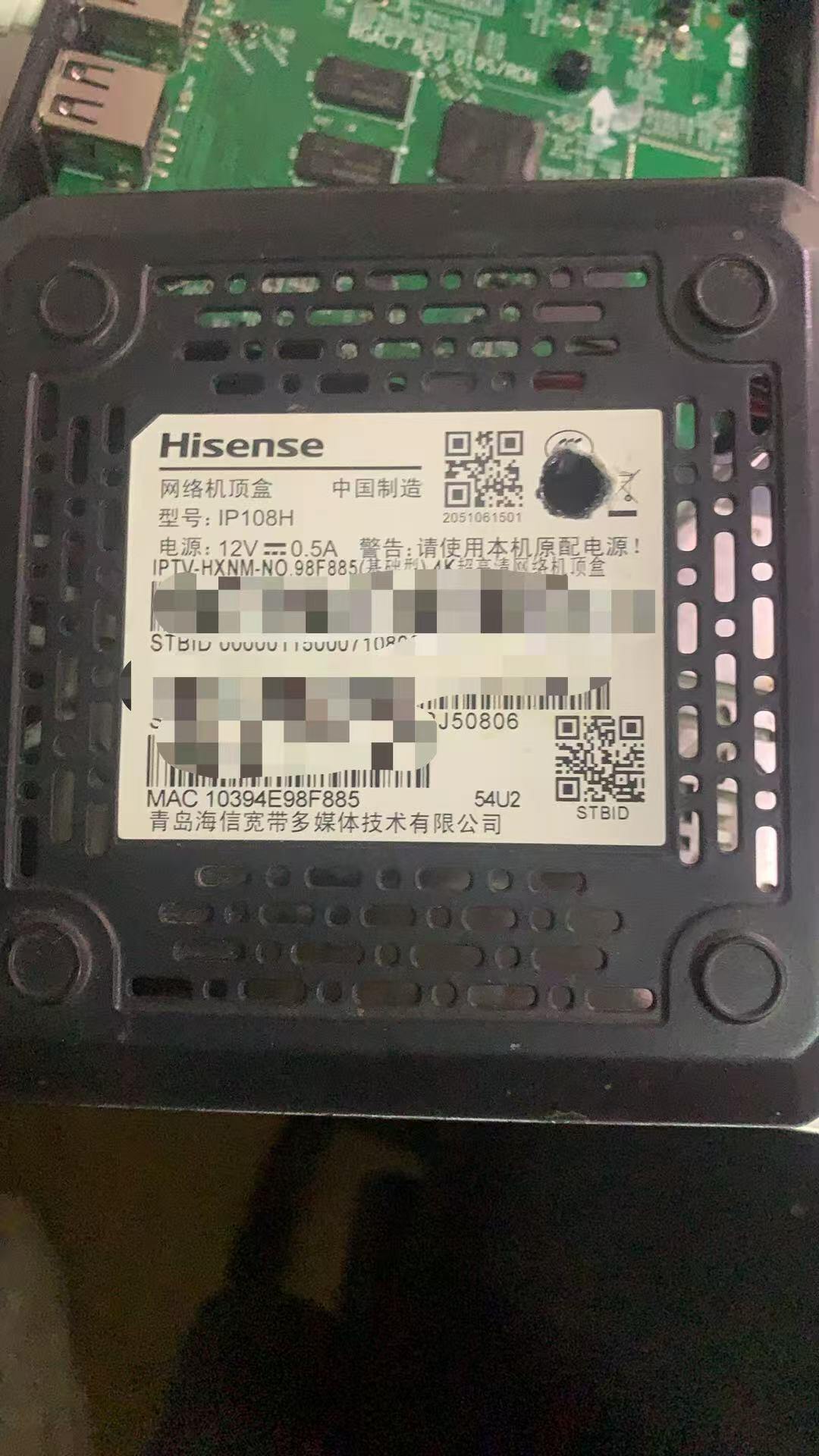

本帖最后由 lc47670416 于 2026-2-10 19:02 编辑 内蒙古联通海信IP108H 54U1机顶盒(1+8),型号内蒙古联通IP108H-54U2_国科GK6323V100C,搞了几天了,TTL、短接都用过了,HiTool及Amlogic_USB_Burning_Tool工具 ...

lc47670416| 来自内蒙古 发表于 2026-2-10 17:53
内蒙古联通IP108H-54U2_国科GK6323V100C    ,联通IP108H-54U2,有包的朋友支持一下,常见网上的包不劳发送了,真的都试过了。是1G+8G的盒子,分区表信息:4M(fastboot),4M(bootargs),12M(recovery),4M(deviceinfo),2M(atf),8M(baseparam),8M(pqparam),20M(logo),20M(logobak),40M(fastplay),40M(fastplaybak),40M(kernel),20M(misc),40M(trustedcore),800M(backup),800M(system),800M(cache),150M(private),8M(securestore)
