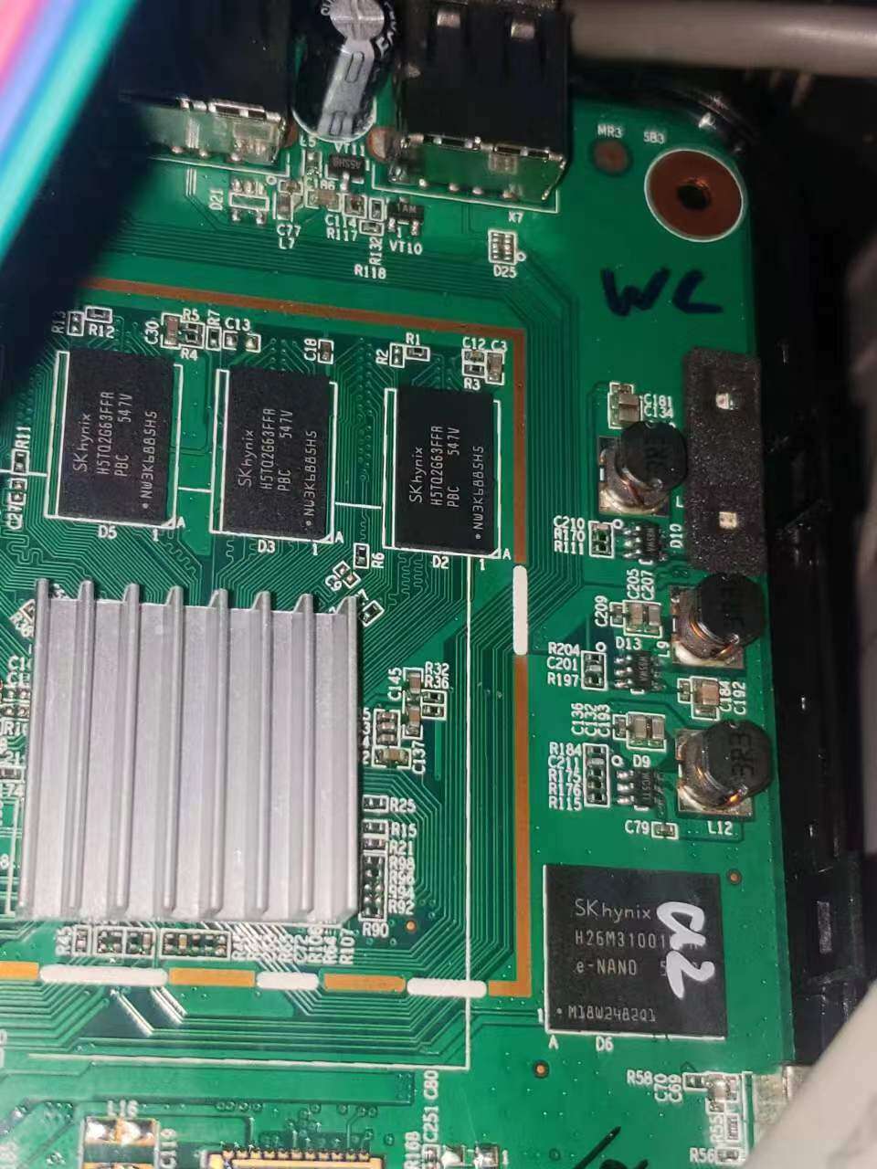

本帖最后由 智能小柠檬 于 2023-2-21 09:48 编辑 TTL返回有错误,(U盘卡刷失败:10015),大神看看怎么救? m8m2_n200_v1# m8m2_n200_v1#safe not found mac in efuse head magic=414e4452 hdcp init_hdcp_ram.. ...
55D2UA| 来自浙江 发表于 2023-2-21 10:51
那就help看看支持哪些命令
cn_heijin| 来自山东 发表于 2023-2-21 09:53
55D2UA 发表于 2023-2-21 09:24
fastboot reboot recovery
未知命令,
  1. m8m2_n200_v1#fastboot reboot recovery
  2. Unknown command 'fastboot' - try 'help'
  3. m8m2_n200_v1#
复制代码
cn_heijin| 来自河北 发表于 2023-2-21 08:53
55D2UA 发表于 2023-2-21 08:50
不带后缀的B860A,记得内置了ota.zip包,试试reboot recovery能不能恢复原厂固件
试了命令,不行,未知命令
试了safe也不行
  1. m8m2_n200_v1#safe
  2. not found mac in efuse
  3. head magic=414e4452
  4. hdcp init_hdcp_ram...
  5. mmc fail to send stop cmd
  6. MMC read: dev # 1, block # 0x20000, count # 0x800, byte_size # 0x0 ERROR!
  7. mmc cmd read failed
  8. nand cmd store failed
  9. Err imgread(L323):Fail to read 0x100000B from part[recovery] at offset 0
  10. Aml log : M8-R1024 IMG fail!
  11. boot system safe failed, try boot norm!
  12. head magic=414e4452
  13. hdcp init_hdcp_ram...
  14. [imgread]Secure kernel sz 0x713120
  15. mmc fail to send stop cmd
  16. MMC read: dev # 1, block # 0x30800, count # 0x3098, byte_size # 0x120 ERROR!
  17. mmc cmd read failed
  18. nand cmd store failed
  19. Err imgread(L358):Fail to read 0x613120B from part[boot] at offset 0x100000
  20. Aml log : M8-R1024 IMG fail!
  21. m8m2_n200_v1#
复制代码
[draw_logo]: draw_logo 1522
before the  decompressToRGB
Start to decode the LOGO jpeg ...
[decompressToRGB]: before the decompress_jpeg_rgb
[decompressToRGB]: Call decompress_pic_rgb565(id=3,addr=1106e1ac,size=423076,maxw=1920,maxh=1080,Bpp=3) ...
[decompressToRGB]: after the decompress_jpeg_rgb
[draw_logo]: Success in decoding LOGO src file: (w=1280,h=720,Bpp=3,data=0x3f2a75f8)
[deinit_Logo]: all LOGO's resource (Exc. logoThread) are released
Logo_disp ret: 0
logo time: (BootPicTime minus 4s to fine tune)
do_bootsys to boot NORM
head magic=414e4452
mmc cmd read failed
boot system norm failed, try boot safe!
head magic=414e4452
mmc cmd read failed
m8m2_n200_v1#reboot recovery
Unknown command 'reboot' - try 'help'
m8m2_n200_v1#
