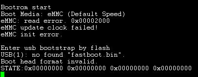

三刅木| 来自四川 发表于 2024-1-18 19:25
qfnuzlr 发表于 2023-1-18 15:13
TTL跑码
Bootrom start
Boot Media: eMMC (Default Speed)
我之前也遇到过,拷了个fastboot.bin到U盘上,插到USB1口上就过了

qfnuzlr| 来自山东 发表于 2023-1-18 15:13
TTL跑码
Bootrom start
eMMC: read error. 0x00002000
eMMC update clock failed!
eMMC init error.
Enter usb bootstrap by flash
USB(1): no found "fastboot.bin".
Boot head format invalid.
STATE:0x00000000 0x00000000 0x00000000 0x00000000
