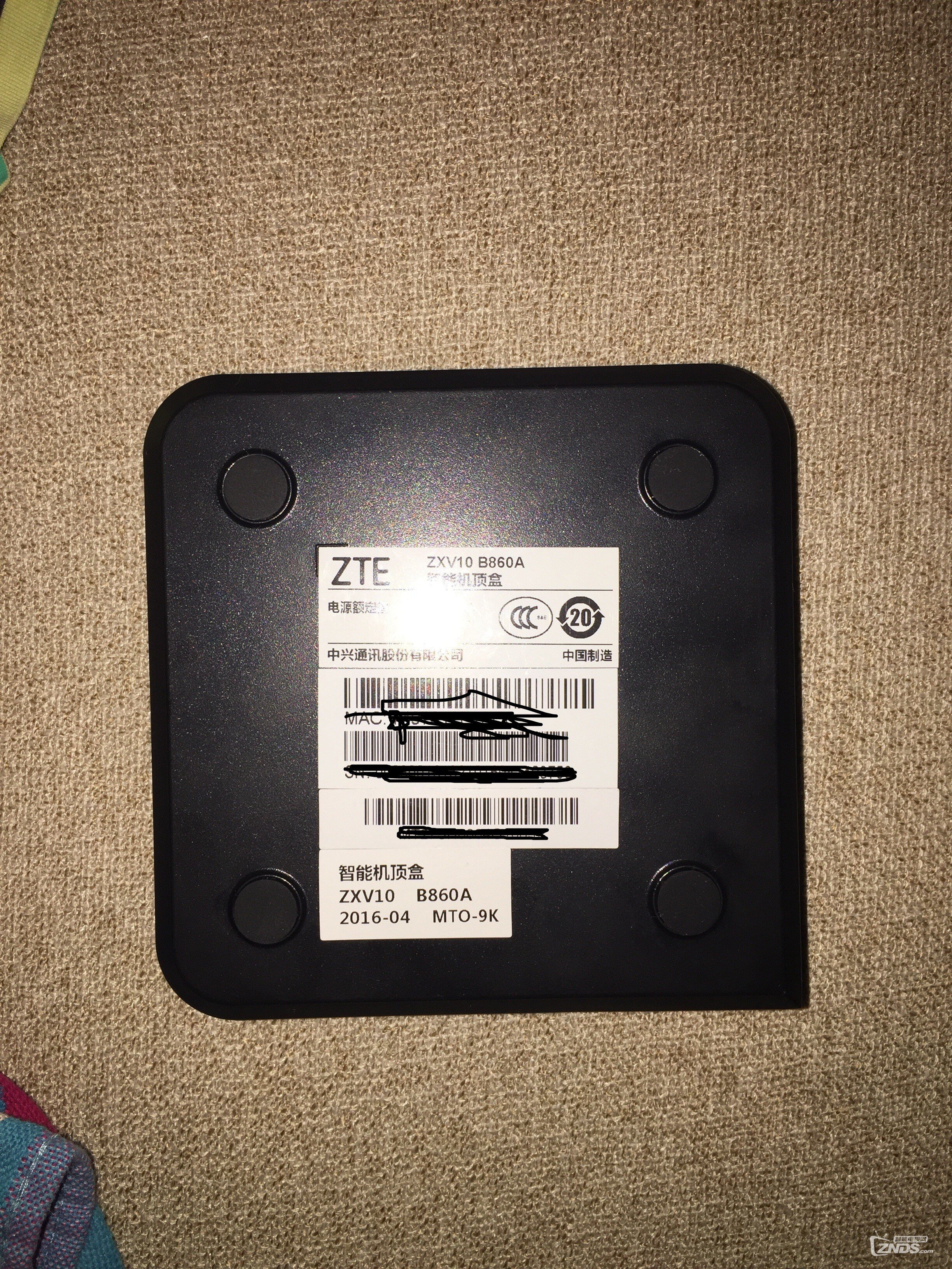

上个星期把宽带升级到200M,电信送了个IPTV两年.结果给带了个中兴zxv10 B860A机顶盒. 进去一看,什么都要收费. 所以只好试试刷机了. 搜索下教程,发现没有上海电信阉割版教程(无WiFi).只有自己动手了. 等了一个星期TTL ...

与LZ同款盒子。 能否分享下固件,我的已经砖了,
CPU clock is 792MHz
BOARD type: 0x04
CPU type: M8M2
DDR info: 1GB(auto) @ 792MHz(1T)+Scramb EN
DDR channel: DDR 0 + DDR 1
DDR init use : 14624 us
HHH
Boot From SDIO C
0x0000008d
Boot From SDIO C get storage
###eMMC switch to usr partition sucess
0x0000008d
0x0000008d
mmc check storage check_sum failed
mmc read storage check data  failed
sdio_secure_storage_get : finished
Aml log : M8-R1024 TPL fail!
QA9:A;SVN:74E;POC:17F;STS:6B730001;SKIP:0;BOOT:1;INIT:10;USB:3;SERIAL:4;STS:6B730000;BOOT:0;INIT:0;READ:0;CHECK:0;PASS:0;
no sdio debug board detected
TE : 12957304
BT : 20:29:59 Dec 27 2017
PMU:rn5t618
DC01 v:1100, 0x[36]: 28 -> 28
DC02 v:1150, 0x[37]: 2c -> 2c
DC03 v:1500, 0x[38]: 48 -> 48
LDO01 v:3300, 0x[4c]: 60 -> 60
LDO02 v:1800, 0x[4d]: 24 -> 24
LDO03 v:1800, 0x[4e]: 30 -> 30
LDO04 v:2850, 0x[4f]: 4e -> 4e
LDO05 v:1800, 0x[50]: 24 -> 24
LDO0a v:2700, 0x[56]: 28 -> 28
LDO0b v:900, 0x[57]: 00 -> 00
